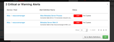

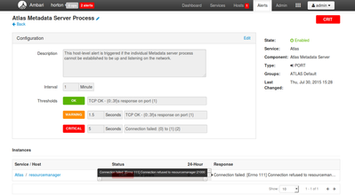

When i tried to "turn off maintainance mode" and start the services, Falcon service running properly without any issue. Atlas Metadata server is starting without any issue and then immediately stopped. I tried to resolve the issue in many ways. But unable to do that. It is giving alerts.

Regarding your atlas service crashing everytime after startup, it could indicate multiple problems.
The most common one could be an out of memory error.
Could you check the logs and share the error stack trace ?
