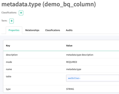

Example bq_column
Example bq_table

Example bq_column
Example bq_table
