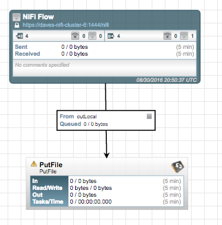

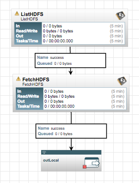

In this case you would install a NiFi instance on your local machine and the Remote Process Group (RPG) would be added to the canvas on that local NiFi instance. The NiFi instance running the RPG is acting as the client in the connection between NiFi instances. On your remote NiFi instance, your dataflow that is fetching files from your HDFS would need to route those files to an output port located on the root canvas level. (output and input ports allow FlowFiles to transfer from one level up in the dataflow. So at the root level they allow you to interface with another NiFi.)
For this transfer to work your local instance of NiFi will need to be able to communicate with the http(s) port of your remote NiFi instance (NCM http(s) port if remote is a NiFi cluster). Your local instance will also need to be able to communicate with the configured Site-To-Site (S2S) port on your remote instance (Need to be able to communicate with S2S port on every Node if remote is a NiFi cluster).

The dataflow on your remote NiFi would look something like this:
The dataflow on your local NiFi would look something like this:
As you can see in this setup the local NiFi is establishing the connection to the remote NiFi and pulling the data from the output port "outLocal".
