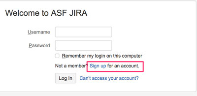

Hi @Gabriel Queiroz
In order to submit a JIRA, please go to the login page and sign-up your account. Then you'll see a red 'Create' button.
https://issues.apache.org/jira/login.jsp
Great, thank you very much!
