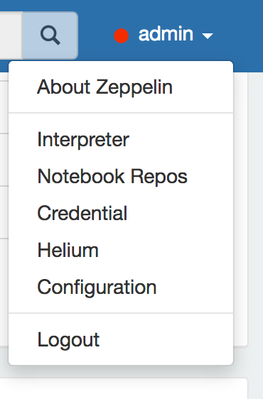

Sharing of interpreter processes is easily adjustable
Go to the interpreter setting page :
And scroll down to the spark interpreter :
By default interpreters are shared globaly : ie - all notes/users share the same interpreter instance (hence the same spark context)
Change the setting to either "per note" or "per user" depending on your use case :
- Per Note : ie - each note will instantiate a separate interpreter process
- Per User : ie - each user instantiates a seperate interpreter process (which is shared amongst the notes for which he/she has ownership)
Below an article written by one of the original developpers of zeppelin describing interpreter modes :
https://medium.com/@leemoonsoo/apache-zeppelin-interpreter-mode-explained-bae0525d0555
Zeppelin documentation:
https://zeppelin.apache.org/docs/latest/manual/interpreters.html#interpreter-binding-mode
