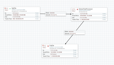

I just did a quick test using GetFile to ingest a PDF, and used the custom processor as is without any configuration. I then used a PutFile to drop the output of the Extracted text to a dir. As expected, the output is the text lifted from the original PDF, in a text file format. No special configuration required. If you are looking to play with the metadata using Tika, you can look at the ExtractMediaMetadata processor which comes with modern versions of NiFi out of the box and uses Tika under the hood.
