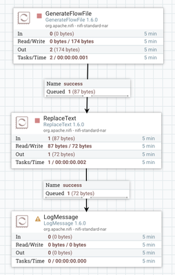

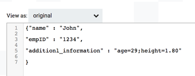

You can use a replacetext processor with a regular expression as in this example I did for you
Example input flowfile

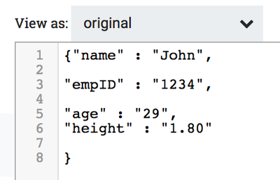

After the replacetext processor with the above configuration

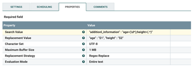

You have to use a replace text Processor and configure it in the following way
ReplaceText Processor will replace content in the flowfile based on a regular expression match.
Everything that matches the regular expression will be replaced.
The key of the regular expression is the use of parentheses (), in the way that the content of the first parentheses can be referenced later as $1 and the content of the second parentheses can be referenced as $2.
Based on your example this is the content of the incoming flowfile
And this the result after the ReplaceText processor with the above configuration
