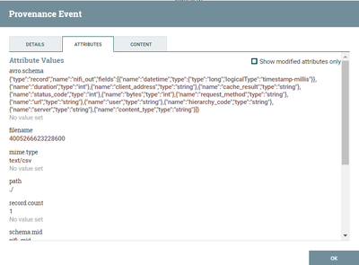

The UpdateAttribute processor does not read the content of a FlowFile. In order for the above Expression Language statements to work, the incoming FlowFile's must have FlowFile attributes "user" and "datetime" created on them.
Stop the UpdateAttribute processor and allow a few FlowFiles to queue. Then list that queue and verify what attributes currently exist on those listed FlowFiles.

@Matt Clarke, thank you for your answer!
I turned off the UpdateAttribute component and turned on the entire flow again. Below are screenshots:
When I re-enabled the UpdateAttribute to component, the information about the attributes is such that @Matt Clarke is right ↓

sorry for the mistake, obviously the operation is performed on the attribute, not on the FlowFile. So you must first set the values you need in the attributes and then transform them.
Thanks @Matt Clarke
