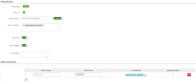

After the installation, we configured policies in Ranger with the rights we wanted (see the picture below for the most permissive policy).
Then, we made a CHMOD -R 700 on test folder to verify Ranger's policy effect.
But it seems that Ranger policies are not considered. Typical error we get with the file view :
org.apache.hadoop.security.AccessControlException: Permission denied: user=test, access=READ_EXECUTE, inode="/tmp/RangerTestFolder":admin:hdfs:drwx------

@Tom C
How can we make RANGER permissions more important than HDFS ones ?
When HDFS authorization is configured with Ranger plugin initially it will try to find a ranger hdfs policy matching the access. If policy matching the resource/user or group is found it will be enforced and without checking for hdfs posix level permissions the user will be authorized or denied depending on the policy. Only if no policies are found matching the resource/user or group then it will fallback to hdfs posix level permissions.
Why is not working on the above example?
On your above example I see you created a policy only for resource slash /, if you intended all path you should use slash and wildcard /*
Furthermore the error you show is Permission denied: user=test
Since user is not listed as part of Select User you should make sure test user belongs to hadoop, hdfs or HDFS_Admin groups.
HTH

Hi @Felix Albani
Thank for your answer.
We already intended the slash and wildcard /* without success unfortunately. We waited a few minutes to let Ranger some time to apply its rules : it didn't change anything.
It really seems that Ranger can't overwrite the HDFS 700 (rwx------) permissions we set before.
We are now working with a specific folder and it's the same problem, but the policy is well configured too :
We are now looking for some parameters in Ranger / HDFS to try and check because Ranger Admin seems to be correctly configured.
