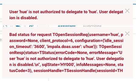

I even tried to log in as the hue user and I get these two error messages.

Super Guru
@mfulwiler,
The "delegation is disabled" error occurs for one reason:
  if (authorized_proxy_user_config_.size() == 0) {
    error_msg << " User delegation is disabled.";
    return Status(error_msg.str());
That means the daemon is not seeing the configuration you mentioned you added for hue=*.  Can you share a screen shot of your Cloudera Manager config and then also show us the "--authorized_proxy_user_config" value during the daemon startup?  It should be in your "/var/log/imapad/impald.INFO" most likely
Based on what we see in the error response, Impalad is not configured for delegation, so Hue cannot leverage delegation.
