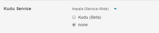

May be I'm missing something, but as I have the kudu service installed on my cluster. In cloudera Impala configuration, what is the difference between setting kudu service or selecting none as in both cases kudu queries works fine.
Thank you for your help.
