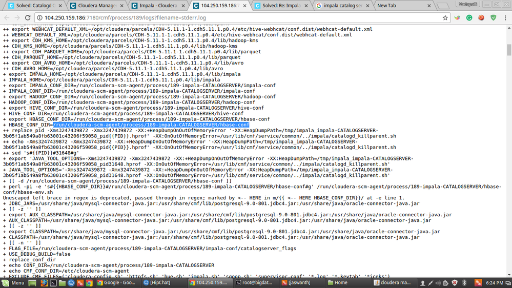

Explorer
Screenshot from 2017-07-06 18-18-18.pngScreenshot from 2017-07-06 18-24-06.png
yes my impala daemon is working after adding the java_tool_options=-Xss2m but as same to catalog server i add java_tool_options=-Xss2m its not starting
and my java version is
java version "1.8.0_131"
Java(TM) SE Runtime Environment (build 1.8.0_131-b11)
Java HotSpot(TM) 64-Bit Server VM (build 25.131-b11, mixed mode)
