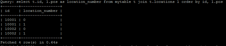

Can you try running this and see if you get the expected results?
select c.id, a.pos from mytable c left join c.`location` a order by c.id, a.pos;

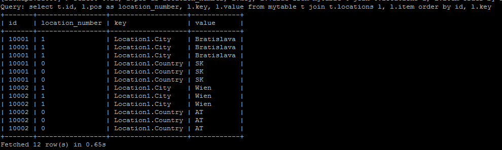

Alternatively try this query if you also want to explode the items within the nested MAP:
select c.id, a.pos, a.key, a.value from mytable c left join c.`location` a, a.item order by c.id, a.pos;

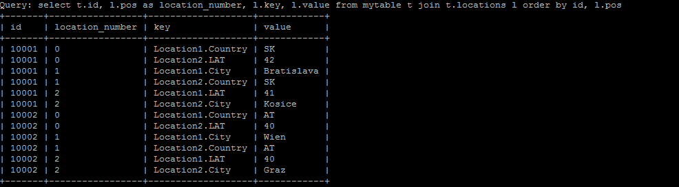

insert into table mytable select 10002, array( map("Location1.City","Wien","Location1.Country","AT","Location1.LAT","40"), map("Location2.City","Graz","Location2.Country","AT","Location2.LAT","40") ) from i limit 1;Query results in Impala:
These results are wrond, what I need is a location_number -
0 for Location1.City
0 for Location1.Country
0 for Location1.LAT
1 for Location2.City
1 for Location2.Country
1 for Location2.LAT
... and so on for every ID in the table.
What you suggested (adding l.item), returned a wrong result set, because City in the result set is twice, but LAT is missing - this seems to be definitely a BUG:

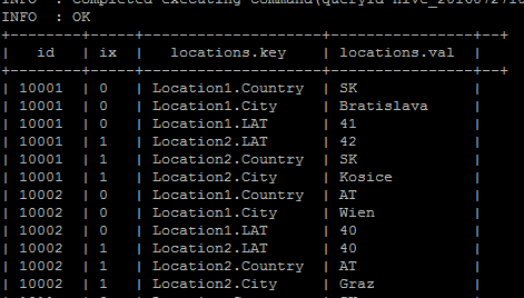

In Hive the solution is:
select id, ix, locations.key, locations.val from ( select id, ix, locs from mytable lateral view posexplode( locations ) x as ix,locs ) tab lateral view explode( locs ) locations as key,val;
which returns the correct result set:
