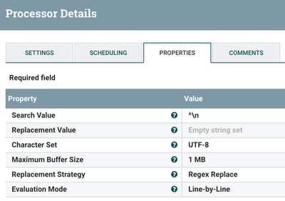

@Mark Heydenrych
You may be able to use the ReplaceText processor to remove those blank lines from your input FlowFile's content before the SplitText processor.
I did a little test that worked for me using the following configuration:
This evaluates your FlowFile line by line and replace the line return (\n) on any line where the line starts with a line return with nothing. The effectively removes that blank line. After that my splitText reported teh correct fragment.count when I split the file.
