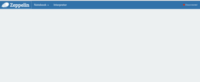

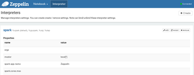

Hi @Artem Ervits,
thank you for the response. I tried the tutorial you posted, but get the same issue. Following, there are the print screen, in which you can see that in the interpreter page all is fine, but I get a "Disconnected" status on the Notebook tab
Thank you,
D.
