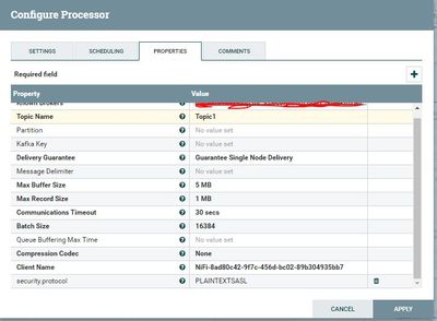

The PutKafka configuration is the following one:
