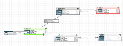

As suggested we implemented the data flow as shown below:
1)The standalone flow(This is where the single source file arrive).The RPG in this flow refers to the cluster i.e NCM url
2)The NCM of the cluster has flow as shown below:
3)In this approach were facing the error as shown below as getting only a subset of the records in HDFS
4)So to avoid the situation we used a MergeContent processor to merge the flowfiles since we were splitting them before loading them to HDFS
5)We configured the MergeContent in the way as shown below:
But even after this implementation we are not getting all the records in HDFS.
The source file has 10000000 records and approximately 5000000 records should go to each HDFS directory. But we are getting around 1000000 records in each Target and the error as shown below in the PutHDFS processors.
We are getting the same error as mentioned in the snapshot attached with the point 3 above.
Are we missing something very intrinsic here? Is there something wrong with the design?
We are using a 3 node cluster with NCM and 2 slave nodes. And the source file is coming to a standalone server.
Let me know if you need any other information. Any inputs would be appreciated.
Regards,
Indranil Roy

Master Mentor
@INDRANIL ROY
The output from the SplitText and RouteText processors is a bunch of FlowFiles all with the same filename (filename of the original FlowFile they were derived from.) NiFi differentiates these FlowFiles by assigning each a Unique Identifier (UUID). The problem you have is then writing to HDFS only the first FlowFile written with a particular filename is successful. All others result in the error you are seeing. The MergeContent processor you added reduces the impact but does not solve your problem. Remember that nodes do not talk to one another or share files with one another. So each MergeContent is working on its own set of files all derived from the same original source file and each node is producing its own merged file with the same filename. The first node to successfully write its file HDFS wins and the other nodes throw the error you are seeing. What is typically done here is to add an UpdateAttribute processor after each of your MergeContent processor to force a unique name on each of the FlowFiles before writing to HDFS.
The uuid that NiFi assigns to each of these FlowFiles is often prepended or appended to the filename to solve this problem:
If you do not want to merge the FlowFiles, you can simply just add the UpdateAttribute processor in its place. YOu will just end up with a larger number of files written to HDFS.
Thanks,
Matt
