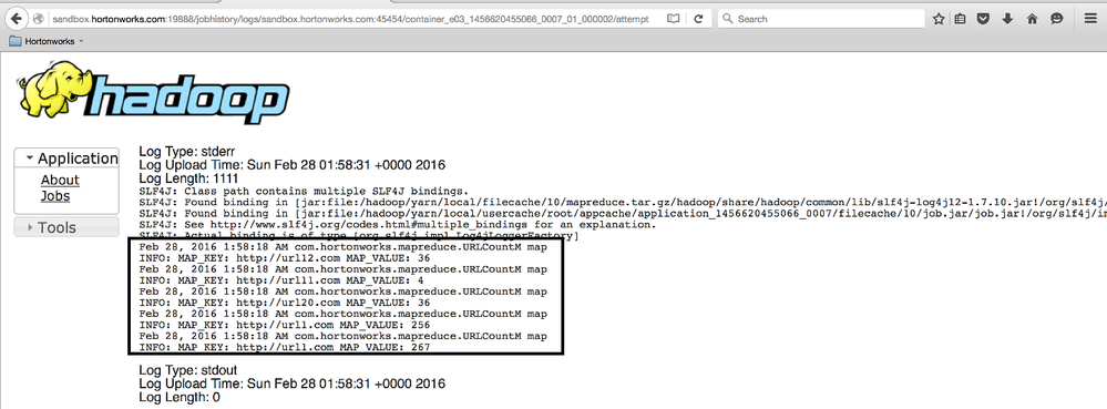

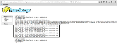

  try{
                    LOG.log(Level.INFO, "MAP_KEY: ".concat(key.toString()).concat(" MAP_VALUE: ".concat(value.toString())));
  context.write(key, new IntWritable(Integer.valueOf(value.toString())));
  catch(NumberFormatException | IOException | InterruptedException e){
   LOG.log(Level.SEVERE, "ERROR: ".concat(e.toString()));
notice I added logger, this is a better way of printing out to log expected keys and values

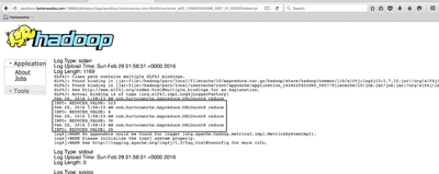

notice I'm printing to log again in reducer, just to keep sanity, below is what it looks like in the logs.

  try{
