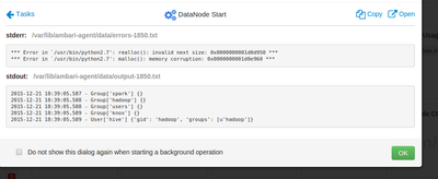

Hi,
When I am starting any service from ambari UI, I am getting below error .. Any pointers on how to fix it? My entire cluster is down as I am not able to start any service because of this error
Ambari version is 2.1.2.1 and hdp version is 2.3

I would check ulimit/top for number of open file handles (any leak over there) or memory consumption by any other process on the machine.

Soft limit is set to 1024 and hard limit is set to 4096, (I know its not HDP recommended)

@abhinav s can you paste errors from ambari logs?

A quick upgrade to glibc has fixed the issue 🙂
