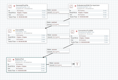

I have an input that is a JSON from which I extract a property that is necessary to build a query against a DB. After I obtain the query results I need to join the result of the query with the rest of the information that is on the JSON from which I extracted a property to do the query.
I extract the property with EvaluateJsonPath, after that I call ExecuteSQL and send the result to ConvertAvroToJSON but now I don't know to merge this with the previous JSON I have.
1 ACCEPTED SOLUTION
Master Guru
@Manuel Carnerero
As you are extracting a property that is necessary to build a query along with that Extract all the required content from the input JSON and keep as attributes to the flowfile.
Make your Join with the extracted property once you get results back now the flowfile content is changed but the extracted attributes will not be lost.
So extract all the required information from the join result content also and keep them as attributes to the flowfile.

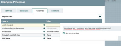

Now you are having all the required values as attributes to the flowfile ,Use AttributesToJSON processor mention all your attribute names in this processor Based on the attribute values processor creates new json message.
Flow:
AttributesToJSON processor configs:
inputjson_attr1,inputjson_attr2 are extracted from first EvaluateJsonPath processor,
joinjson_attr1,joinjson_attr2 are extracted from second EvaluateJsonPath processor and now we are merging both results into one json message.

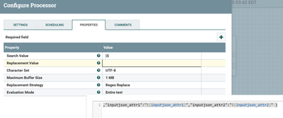

After ConvertAvroToJSON processor we can also use ReplaceText processor to search for } (or) }](if the wrap single record is set to true) and replace with all the attributes that are extracted from the input Json message.
Flow:
ReplaceText Configs:
earch Value
Replacement Value
,"inputjson_attr1":"${inputjson_attr1}","inputjson_attr2":"${inputjson_attr2}" }
Maximum Buffer Size
1 MB //change the size according to your feeding input flowfile size
Replacement Strategy
Regex Replace
Evaluation Mode
Entire text
we are preparing key/value pairs in replace text processor by searching end of json message and replacing that with inputjson attributes adding the close curly braces at the end.

Master Guru
@Manuel Carnerero
Flow:
Flow:
earch Value
Replacement Value
Maximum Buffer Size
Regex Replace
Evaluation Mode
Entire text
