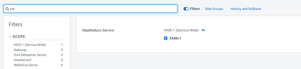

Hi Community. I am getting an error starting Hive in Cloudera Manager, CDP7. The error reads, "Command failed to run because service Hive has an invalid configuration. Review and correct its configuration. First error: Missing service dependency for Hive: YARN".
How do I add the YARN dependency to an existing Hive service? Reinstalling Hive is not a really practical solution. Is there any way to add the dependency without reinstalling Hive?

@hitachi_ben Go to CM > Hive > Configuration and then set MapReduce Service to YARN. For example below.
Let me know if this helps.

Thank you @GangWar, that fixed my issue.
