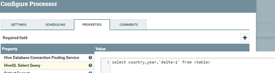

@mayki wogno
Can you use hive escape character in your select statement
Hive escape character:-
Use the above character to escape from your select statement and try to run select HiveQL again
New Select HIVEQL statement:-
select country,year,`delta-1` from <table>
Select HiveQL Processor config Screenshot:-
