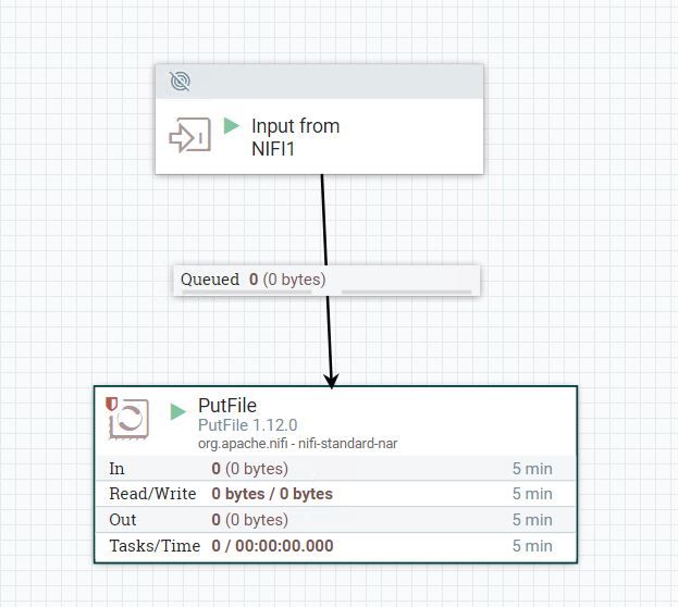

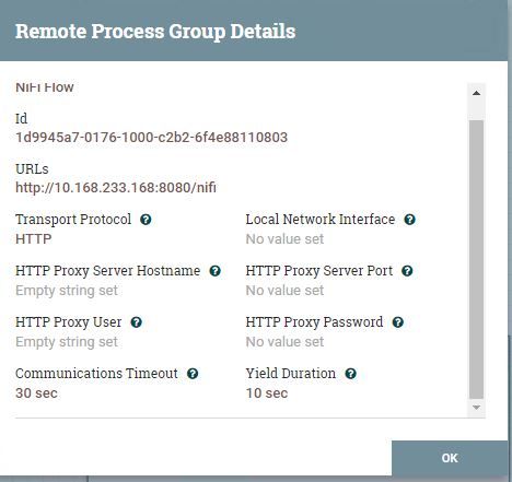

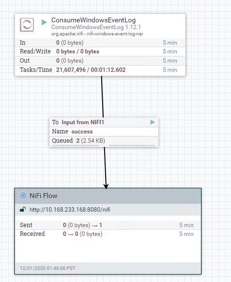

I'm trying to create a site to site connection between 2 Nifi servers. Nifi1 (Hostname wef2 - running on windows) need to deliver traffic to nifi2 (IP 10.168.233.168 - running on Linux) - I defined the connection and all is green but on Nifi1 I'm getting the following error messages
What am I missing?
*port ID 0176100c-8d25-196b-1f72-6befa5cab12a is the input port in NIFI2

Nifi 1
NIFI 2

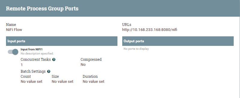

Remote processor
Remote process configuration

Does
match the id for Input from NiFi 1
also right click to make sure you started.   you may need to do a refresh.
are both clusters or single nodes?
Restart both nodes.

Seeing "localhost" in your shared log output leads to what may be the issue.
When you configure the URL in the Remote Process Group (RPG), it tells that NiFI RPG to communicate with that URL to fetch the Site-To-Site (S2S) details.  Included in those returned details are things like:
- number of nodes in target NiFi cluster (if standalone returns only one host)
- The hostnames of those node(s) (in this case it looks like maybe localhost is being returned
- Configured RAW port if configured
- Whether HTTP transport protocol is enabled
- etc...
So when you RPG actually tries to send FlowFiles over S2S it is trying to send to localhost which results in itself rather than the actual target linux NiFi it fetched the S2S details from.
When some properties are left unconfigured, NiFi returns whatever the OS resolves.
I am going to guess your linux server is returning localhost rather than the actual hostname.
You will want to verify your S2S configuration setup in the target NiFi (linux server):
http://nifi.apache.org/docs/nifi-docs/html/administration-guide.html#site_to_site_properties
Try setting the "nifi.remote.input.host" to see if that helps you.
