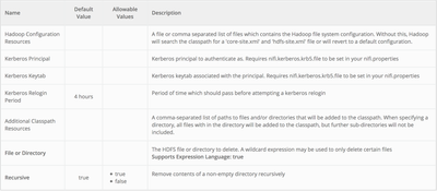

Make sure the user your NiFi is running as is authorized to delete files and directories in your target HDFS.
The DeleteHDFS processor properties are as follows:

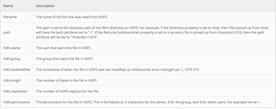

FlowFiles generated by the listHDFS processor all have a "path" attribute created on them:
That attribute could be used to trigger you directory deletion via the DeleteHDFS processor.

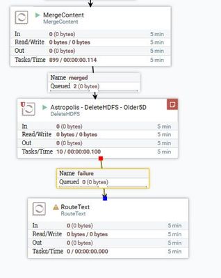

Do you know if it is possible to move to the next flowfile and send failed flowfile to the next processor ?
I'm trying to send one of failure flowfile from deleteHDFS to RouteText but nothing goes to.
Master Mentor
@mayki wogno
One thing you could do is set "FlowFile Expiration" on the connection containing the "merged" relationship. And set the "Available Prioritizers" to " Newest FlowFileFirstPrioritizer". FlowFile expiration is measured against the age of the FlowFile (from creation time to now) and not how long it has been in a particular connection. If the FlowFile age exceeds this configured value, it is purged from the queue.
