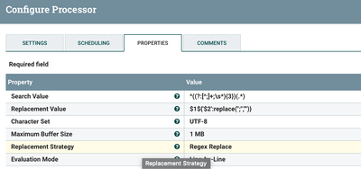

Method2:Using ReplaceText processor:
Use this method if you are dealing with less number of records
Search Value
^((?:[^;]+;\s*){3})(.*)
Replacement Value
$1${'$2':replace(";","")}
Character Set
UTF-8
Maximum Buffer Size
1 MB //change this value according to your flowfile size
Replacement Strategy
Regex Replace
Evaluation Mode
Line-by-Line
In this method we are using regex to match until third ; to first capture group($1) and rest of the data into $2 capture group.
Making use of NiFi expression language we are replacing ";" in $2 capture group with ""
OutputFlowfile:
column1;column2;column3;20180927column1_1;column2_1;column3_1;20180927column1_2;column2_2;column3_2;20180927

Master Guru
@Pepelu Rico
You can achieve this by using ReplaceText processor (or) UpdateRecord processor
Method1:Using UpdateRecord processor:
If you are working on larger number of rows then use UpdateRecord processor and define CSV Reader controller service with ; as value seperator.
Define CSV writer controller service add new property in the Processor as
/link3column as
concat(/col_4,/col5,/col6)
Refer to this link for configure/Usage of UpdateRecord processor.
Search Value
Replacement Value
Character Set
UTF-8
Maximum Buffer Size
Regex Replace
Evaluation Mode
Line-by-Line
OutputFlowfile:
