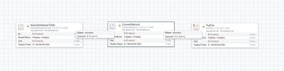

Hi, I tried to implement using ConvertRecord Processor and getting below error:
SchemaNotFoundException: Flow File did not contain appropriate attributes to determine Schema Name.
