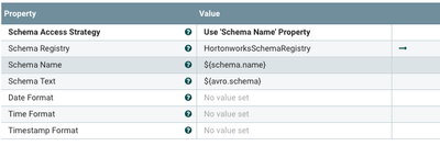

Can you share the configuration of AvroRecordSetWriter? That file doesn't look like it has a schema embedded in it (you can usually see the schema as JSON near the beginning of the file contents). You may need to configure the writer to embed the schema for use by ConvertAvroToORC or avro-tools (if you don't separately provide the schema to the latter).

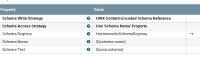

Master Guru
I think the issue is with the HWX Content-Encoded Schema Reference, this is a special "header" in an avro file which makes it easy to integrate with HWX Schema Registry serializers and deserializers, but likely precludes it from being understood by Apache Avro readers such as the one in ConvertAvroToORC or avro-tools. If you can, try setting the Schema Write Strategy to Embed Avro Schema; this will result in larger flow files but should work in downstream processors. If/when there is a OrcRecordSetWriter, you should be able to reuse the HWX schema reference option there.
