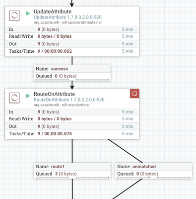

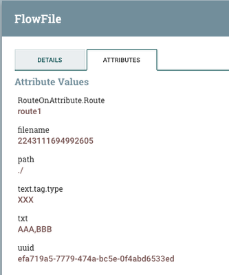

Your NiFi expression Language statement looks good. I even tested base on your example and it routed my flowfiles correctly
Make sure that each of the FlowFiles being processed have required FlowFile Attributes set on them.
You can stop your RouteOnAttribute processor and allow a few files to queue in the connection feeding it.
Then right click on connection and select "List queue". You can then click on "details" icon to far left of any FlowFIle to verify that it does have correct attributes set on it.
