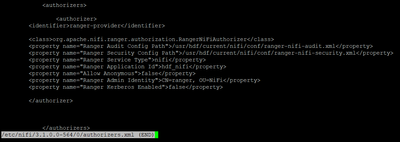

Here is my config and some log files.
authorizers.xml:

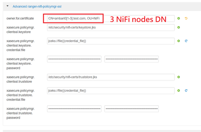

I have three NiFi ranger plugin certificate with DN [CN=ambari01.test.com, OU=NiFi、CN=ambari02.test.com, OU=NiFi、CN=ambari03.test.com, OU=NiFi]
A nifi user is manually created in Ranger admin UI as internal.
The following images are my Ranger/Ambari screen shot and question
1.Do the nifi user need to create certificate too?
2.Is the nifi user a OS user in NiFi host or also a NiFi application user?
#nifi user in Ranger admin
#ranger_nifi_policymgr
