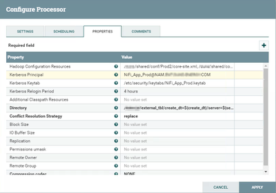

Re: NiFi PutHDFS Login Failure using kerberos
@Benjamin Hopp
How is the PutHDFS processor configured?
Rising Star
Other than the config xmls and kerberos everything is default.
