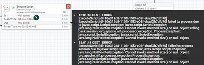

Hi, I need create groovy script to count th fileflows, this is my script:
def trigger = session.get()
def flowFiles = session.get()
if(flowFiles.size() < 9) {
session.transfer(flowFiles,REL_SUCCESS)
}else {
session.transfer(flowFiles, REL_FAILURE) }
I want launch a script if de fileflow files are < 9.
But the error is:
5 REPLIES 5
Re: NiFi - Script count fileFlows Groovy
session.get() only returns a FlowFile reference (or null if one is not available). Instead you want something like
session.get(9)
which will return a List<FlowFile> guaranteed not to be null, but it may have size < 9 so your check should work in this case. Having said that, are you sure you want to transfer them to failure? If you're planning on just routing them back to the ExecuteScript (until 9 are available) then you could just do session.rollback() or session.transfer(flowFile, Relationship.SELF)
