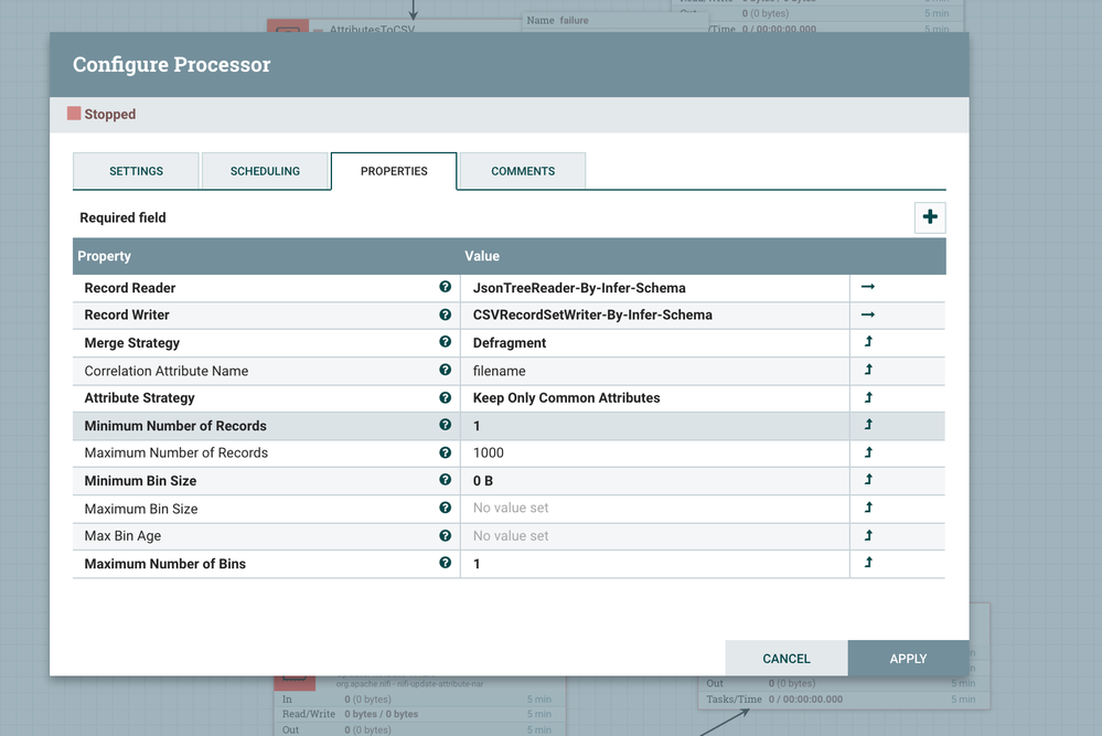

The following is the MergeRecord processor settings.

So I can't see what specifically is wrong here, but I can tell you I've done the same thing using MergeContent. I use the bin packing algorithm with binary concatenation.
Just another thought, you might be able to change the run schedule of the merge processor to only run once a minute or something. That might insure that all the successful flowfiles will have queued up behind the processor before it executes.
