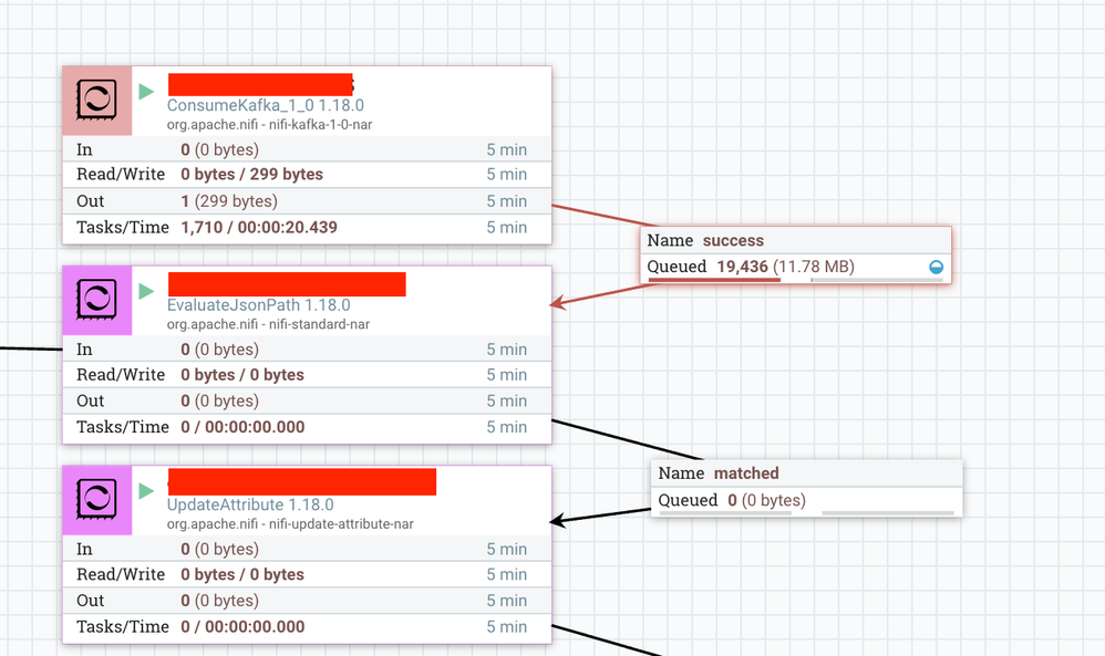

We have a NiFi Cluster 1.18.0 (still so, yeap, sorry) and next issue do my mind.
Simple flow, where we read data from Kafka with ConsumeKafka Processor and process it with EvaluateJsonPath after.
One time we can see that queue between processors are stuck with data and nothing happens while EvaluateJsonPath or whole canvas not restared (right click -> stop -> start):

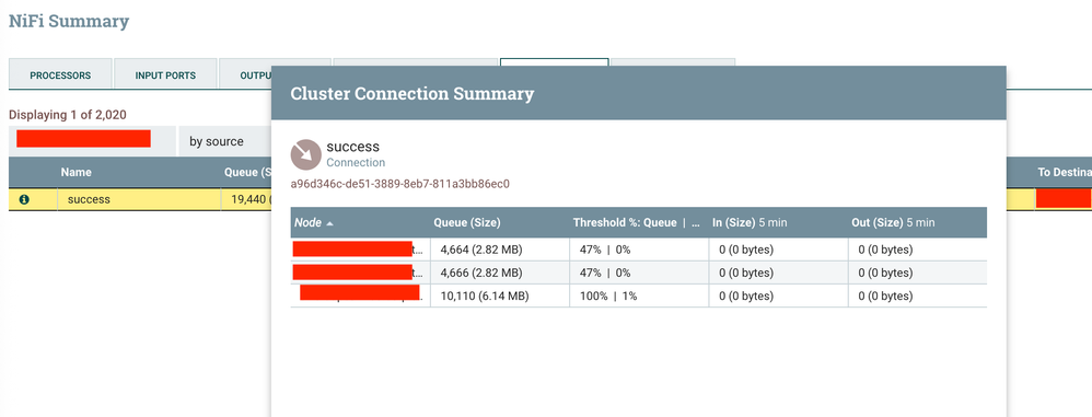

Connection settings:
  • Back Pressure Threshold: 10 000;
  • Size Threshold: 1 Gb
  • LB Strategy: Round Robin
Queue threshold exceeded only on 3rd cluster node:Screenshot 2025-08-11 at 16.33.52.png

So, as soon as I stop and start canvas -- all works fine again. Why it happens? How can I find the reason?

Here are my observations from  what you have shared:
  1. You appear to be having a load balancing issue.  The LB icon on the connection indicates it is trying to actively load balance FlowFiles in that connection.  MattWho_0-1755000276724.png If load balancing is complete the  icon will look like this:  MattWho_1-1755000344777.png.  The  shared queue counts show that 1 node has reached queue threshold which would prevent it from receiving any more FlowFiles which includes from other nodes.  So I assume that the ~4,600 FlowFiles on first 2 nodes are destined for that third node but can not be sent because of queue threshold.
  2. Considering the observation above, i would focus you attention on the node with the queue threshold. Maybe disconnect it from cluster via the cluster UI and inspect the flow on that node directly.  Check the logs on that third node for any reported error or warn issues.
  3. Perhaps EvaluateJson processor only on node 3 is having issues?  Maybe connectivity between first two nodes and and third node is having issues. Node 3 can't distribute any FlowFiles to nodes 1 or 2.  And nodes 1 and  2 can't distribute to node 3.  Maybe some sync issue happened node 3 for some reason has processor stopped. This may explain the stop and start of canvas getting things moving again.  If you just disconnect node 3 (one with queue threshold exceeded) only and then reconnect it back to cluster, do FlowFiles start moving?  At reconnection, node 3 will compare its local flow with cluster flow.  If you remove the LB connection configuration, do FlowFiles get processed?
