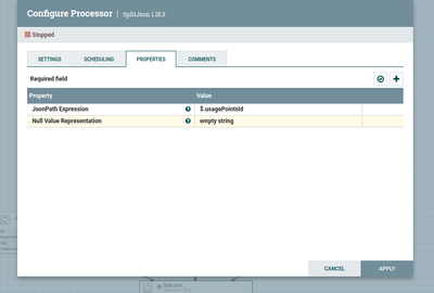

Then i split this array with SplitJson on the usagePointsId path.
It results multiple files with a simple string in content :
How can i save that kind of data as Attributes ? I try to use EvaluateJsonPath but unfortunatly, there is no path to precise. Is there a way to handle that ?
