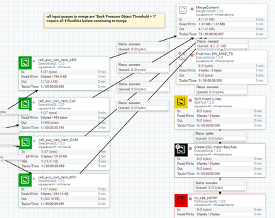

I have 4 Hive queries returning 4 separate flowfiles going in to Merge. I'd like the 4 files to be merged into one, but everything I've tried is not working.
-all input queues to merge are "Back Pressure Object Threshold = 1"
-require all 4 flowfiles before continuing to merge
4 files go in and 4 files come out?

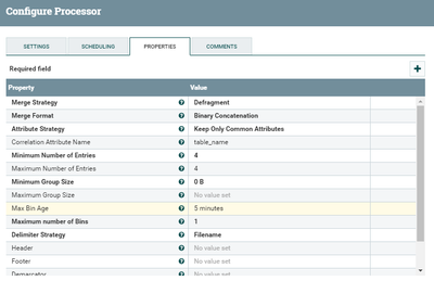

The issue you are most likely running in to is caused by only having 1 bin.
https://issues.apache.org/jira/browse/NIFI-4299
Change number of bins to at least 2 and see if the resolves your issue.

Assuming that all FlowFiles are on same NiFi instance, the only way I could reproduce your scenario was:
  1. Each FlowFile had a different value assigned to the "table_name" FlowFile Attribute and Merge Strategy was set to "Bin-Packing Algorithm". This caused each FlowFile to be placed in its own bin. At the end of 5 minutes max bin age, each bin of 1 was merged. If the intent is always to merge one FlowFile from each incoming connection, what is the purpose of setting a "Correlation Attribute Name"
  2. Setting Maximum number of bins to 1 and having 4 source FlowFiles become queued at different times.
  3. The "Defragment" Merge Strategy will bin FlowFiles based on FlowFiles with matching values in the "fragment.identifier" FlowFile Attribute. It will then merge the flowFiles using the "fragment.index" and "fragment.count" attributes. Since you have also specified a correlation attribute, the MergeContent processor will instead use the value associated to that attribute instead of "fragment.identifier" to bin your files. If I have unique values on each FlowFile for "table_name", then each FlowFile ends up in a different bin and are routed to failure right away (if bins set to 1) or after 5 minutes max bin age since not all fragments where present.
  4. The other possibility is that "fragment.count" and "fragment.index" is set to 1 on every FlowFile.

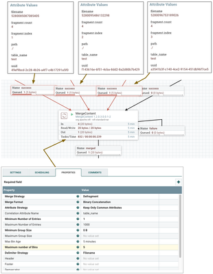

I setup a similar dataflow that is working as expected. The only difference is you made your fragment.index values 0-3 and I made mine 1-4. Is the FlowFile Attribute "table_name" set on all four FlowFiles? Is the value associated to the FlowFile Attribute "table_name" on all 4 FlowFiles exactly the same?
Below is my test flow that worked:
As you can see one 4 FlowFile merge was successful and a second is waiting for that 4th file before being merged.
Thanks,
Matt
