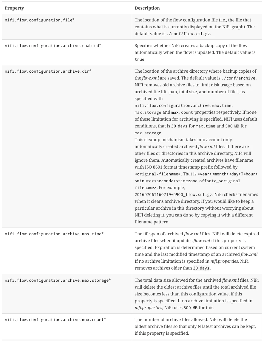

The following properties from the nifi.properties file control where the flow.xml.gz is written and if/how the archiving is setup:
Recovering the flow from archive is as simple as copying the latest "<timesatmp>_flow.xml.gz" from the configured archive directory to the configured NiFi configuration file location and renaming it to "flow.xml.gz".  Make sure proper ownership and permissions are set after you copy and rename (Must be owned and accessible by the NiFi service user).
