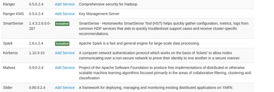

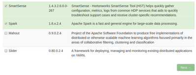

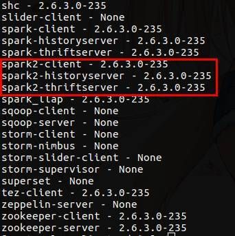

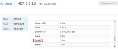

After upgrading Ambari from 2.2.2 to 2.6.0.0 and HDP from 2.4.3 to 2.6.3.0, I tried adding service spark2. I followed this guide , tried to add new service but could not find spark2. I checked the services in Admin -> Stack and Version and No spark2 there but I found Spark2 in Admin -> Manage Ambari -> Versions -> HDP2.6.3.0. And hdp-select also shows spark2 is in hdp repo
