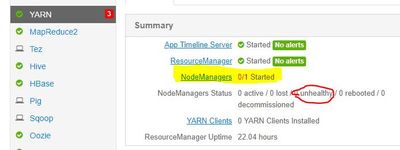

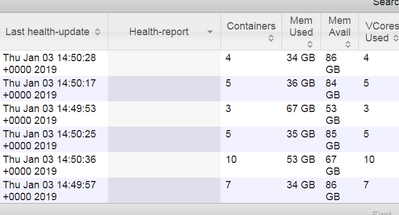

you said "ll your NodeManagers should be listed there and the reason for it being listed as unhealthy may be shown here"
but I not see anything about health nodemanager
see please the follwing:
Michael-Bronson
