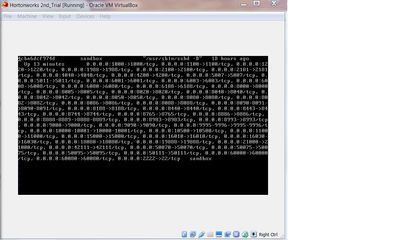

@Jose Johny
Would it be possible to get a screenshot of what your "docker ps" looks like? Thanks!
Explorer
@Edgar Orendain
Please find "docker ps" screenshot.
thx
Jose
