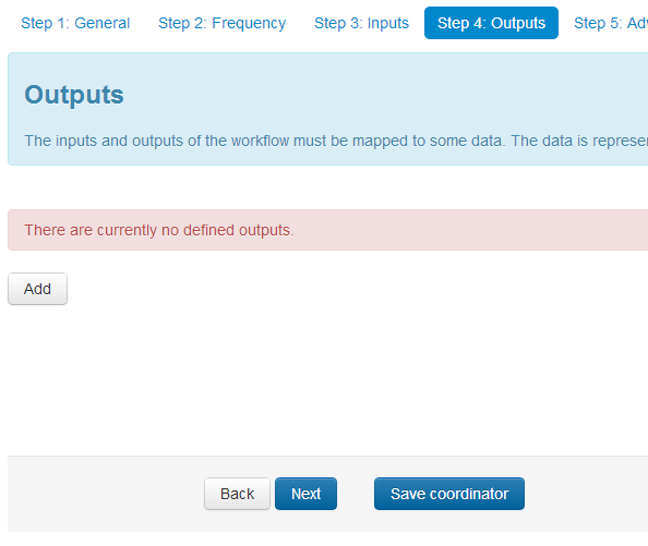

1. Started with no outputs

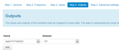

2. Just pick the dataset, but has not clicked on save

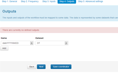

3. After click on save at the bottom of Step 4, I was brought back to Step 1, so I navigated back to step 4, and this is what I see: (please note the message in red)
If I click on Save coordinator here, I am brought to step 1, navigate back to step 4, show the same pick above

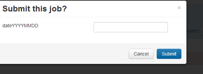

4. If I click on submit, popup box appears and asking to input dateYYYYMMDD.

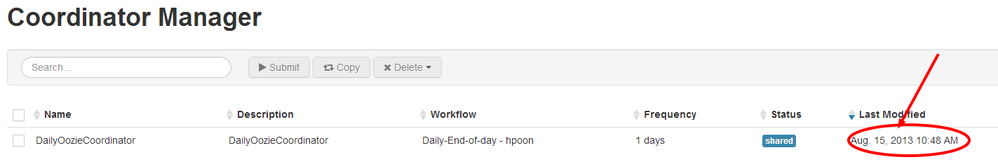

5. When canceled out and relist coordinators, I get the following showing the a old last updated time
Screen 1 has the message in red saying no outputs defined. As soon as I click on Add, the message disappeared. So screen 3 shows both red message that no outputs defined and the output I just defined and saved which might also be a symptom of something went wrong.
