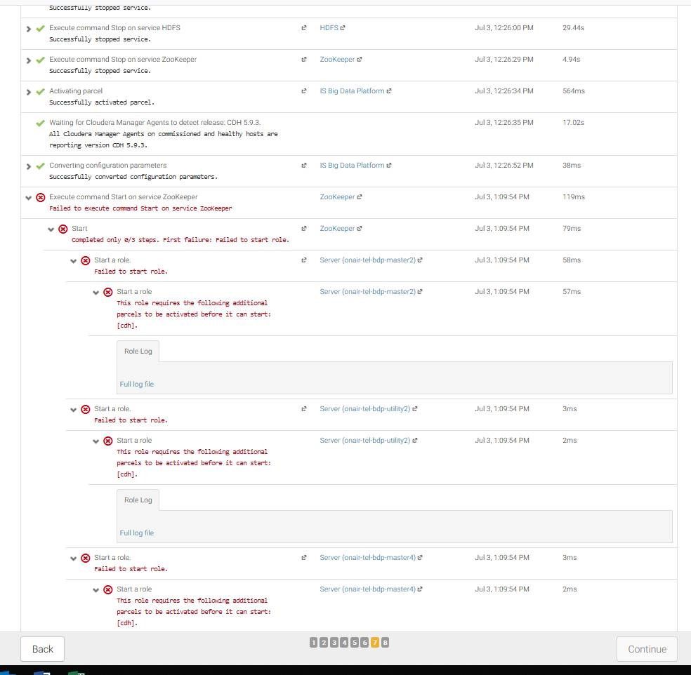

I tried to upgrade CDH fro 5.9.0 to 5.9.3.
I used Cloudera Manager:
  • Downloading, distribution and unpacking of new parcels was done without problems.
  • Stopping services was done without problems.
  • Activation of new parcel also was done without problems. I got in CM info "Activating parcel - Successfully activated parcel."
  • But ferst service to start - ZooKeeper - did not start. I got message: "This role requires the following additional parcels to be activated before it can start: [cdh]"
I was not able to finished and I returned to 5.9.0.
This screenshot shows the error messages:
I'm tring to find the reason of upgrade failure.
What should I checked?
When I'm checking different elements I have some questions.
Thanks for any answers or advice.

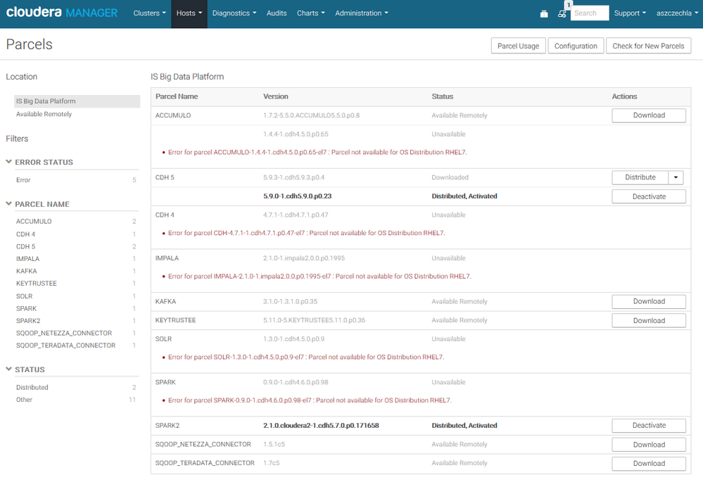

2. In Cloudera Manager/ Parcels I have all time such errors? Should I be worring about them?
Example: Error for parcel SPARK-0.9.0-1.cdh4.6.0.p0.98-el7 : Parcel not available for OS Distribution RHEL7.
I have CentOS 7 not RedHat?

You have many parcel urls in your Parcels configuraiton that do not support el7.  You can remove the parcel urls that you do not need:
Impala
CDH4
Spark
Solr
To remove the parcel URLs, go to Administration --> Settings --> Parcels.
Once these are removed, Cloudera Manager will no longer try to find parcels for your el7 hosts.

(4)
Yes, indeed something very odd happened here, so I agree that cleaning up and trying again is the right path to success.

(2)
Impala
CDH4
Spark
Solr
