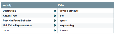

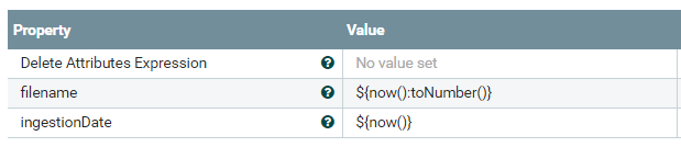

Thank you Matt, I was finally able to generate the JSON as well as the dynamically injected 'ingestionDate'. However the output JSON is all escaped with \" for the strings keys/values, is there a way to strip of those or not have it in the first place?
Below is the snippet of JSON and screenshots of the modified processors.
Output JSON -
{"items":"[{\"date\":\"2016-11-01T00:00:00\",\"pointsMax\":100,\"respPeriod\":\"2016-11\"},\"details\":[{\"detail\":[{\"meta\":{\"answers\":[{\"text\":\"11/1/2016 \"}]},\"id\":56184,... ... }}]}]","ingestionDate":"Tue Jan 03 18:17:15 IST 2017"}
EvaluateJSONPath
UpdateAttribute
AttributesToJSON

Something doesn't look right to me or some of the parameters may have been left out. I see you are manipulating one attribute (ingestionDate), yet all the attributes are being returned in your input/ output examples.
The way we do this to consider the attributes and data payload as distinct. The EvaluateJsonPath moves the data to attributes and the AttributesToJson moves the attributes to data.
In this way, when EvaluatingJsonPath, you can leave ingestionDate out since you do not need it. What you need are the other Json values so they move into the attributes. Then UpdateAttributes by adding the ingestionDate with the Now(). Then AttributesToJson to move all the atrtibutes including the new ingestionDate into the data.
It wouldn't surprise me if internally you don't either have two ingestionDate attributes or your code is ignored to prevent that situation.
Either way, the way I described we think is more maintainable you can see exactly what is going in and out of attributes to data it each step and not have to look at a bunch of transformations.
