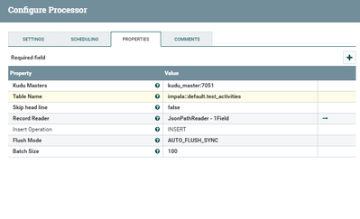

My PutKudu configuration is:
I tried to use several Flush Mode values (AUTO_FLUSH_SYNC, AUTO_FLUSH_BACKGROUND), different Batch size values (2, 10, 100, 1000, 10000) and different Record Readers (AvroReader, several JsonPathReaders).

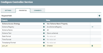

For now I extract 1 field from JSON object via JsonPathReader and store it into Kudu table with 1 column. JsonPathReader configuration is:
I checked that key "fieldid" exists in JSON and its value is GUID string. Table "impala::default.test_activities" with 1 string column "json_str" created via Impala. I added 1 test row to it. Also i checked existing of table with "kudu table list localhost:7051" command on kudu_master.
AvroSchemaRegistry configuration is:
and "All" schema is
