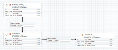

Flow:

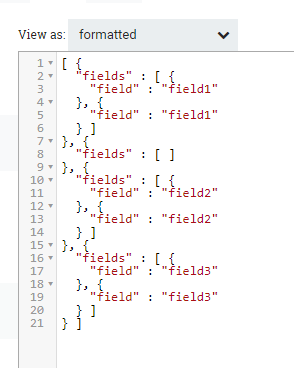

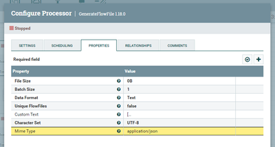

GenerateFlowFile:
Custom Text:
		"fields": [
				"field": "field1"
				"field": "field1"
		"fields": []
		"fields": [
				"field": "field2"
				"field": "field2"
		"fields": [
				"field": "field3"
				"field": "field3"
Expected output: To filter out the 2nd object whose field is an empty array

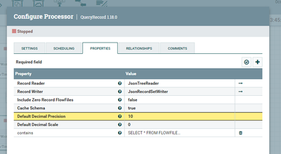

QueryRecord:
Record Reader and Writer services are set to infer the schema

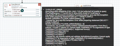

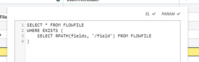

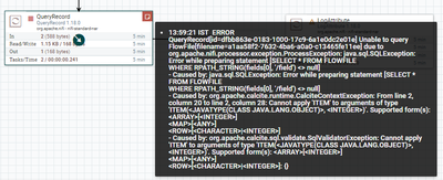

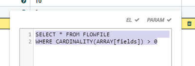

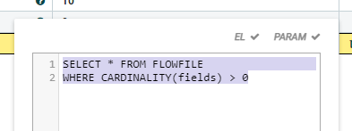

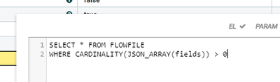

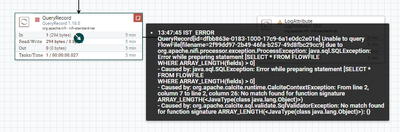

Solutions Tried:
1.
2.
3.
No Error but didn't filter out

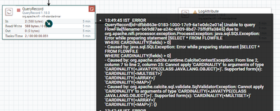

4.
5.
