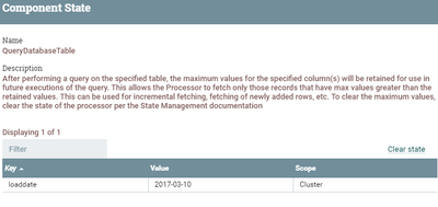

In Maximum-value columns use cast or some other functions that can change the format of 2017-11-11 20:30:32.0 to 2017-11-11 20:30:32
in this screenshot i did cast on the filed name to date and when i see the view state then the processor having just date as the last value.
State:-
Like this way you need to prepare the max value column that can store as 2017-11-11 20:30:32 not with the milliseconds.
State:-

@Shu this worked Thanks a lot, appreciate it
