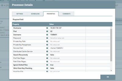

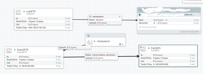

I am trying to configure the RPG in my cluster environemt (3nodes) how to distribute the data between the 3 nodes.
This the below processor i am trying with RPG but it not processing at all attached the details FYR.
Kindly help me to close this thread.
1 ACCEPTED SOLUTION
Hi @Anishkumar Valsalam
What do you mean by 'it's not processing' ?
I see all your counters at zero. Do you have data in your ftp server? if you previously ingested the data, did you clear the state of the ListSFTP processor ?

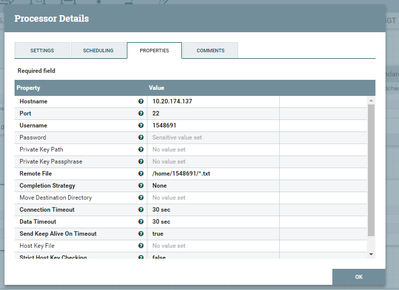

@Abdelkrim Hadjidj Thanks if the new file comes it processing and it fetch to hdfs but i am getting the below error also in Fetchsftp.
2017-11-02 01:56:41,942 ERROR [Timer-Driven Process Thread-5] o.a.nifi.processors.standard.FetchSFTP FetchSFTP[id=788c7b35-015f-1000-0000-00000f3979fd] Failed to fetch content for StandardFlowFileRecord[uuid=af918b98-5632-4877-9876-221477204e73,claim=StandardContentClaim [resourceClaim=StandardResourceClaim[id=1509553663114-11, container=default, section=11], offset=677691, length=0],offset=0,name=a.txt,size=0] from filename /home/1548691/*.txt on remote host 10.20.174.137:22 due to java.io.IOException: Failed to obtain file content for /home/1548691/*.txt; routing to failure: java.io.IOException: Failed to obtain file content for /home/1548691/*.txt
2017-11-02 01:56:41,943 ERROR [Timer-Driven Process Thread-5] o.a.nifi.processors.standard.FetchSFTP

Caused by: com.jcraft.jsch.SftpException: /home/1548691/*.txt is not unique: [/home/1548691/b.txt, /home/1548691/HKLPATHAS03.txt, /home/1548691/a.txt]

The error is that you are trying to access to a file *.txt which doesn't exist. You should use the filename property instead of *.txt. This property will be set by the list processor as an attribute
Use this in the Remote File attribute of FetchSFTP
${path}/${filename}
To test you need to right click on ListSFTP and click on forget state
Contributor
Hi Abdelkrim,
Thanks its working now
The same we can do in standalone as well right? in rpg also it taking from one node? how we can process from multiple nodes and balance the load.
Why we need to put input port in outside of processor group? root path.
Great. Yes you can use the same approach. To have load balancing you need lot of files. If there's only few files, NiFi will not balance because it optimizes with batching.
