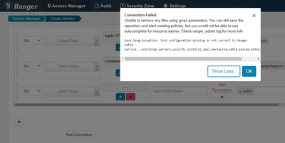

Tried testing the ranger service connection and it is getting failed with message "JAAS configuration missing or not correct in Ranger"
Ranger-admin log:
2021-11-16 12:00:58,661 ERROR org.apache.ranger.services.kafka.RangerServiceKafka: <== RangerServiceKafka.validateConfig Error:java.lang.Exception: JAAS configuration missing or not correct in Ranger Kafka Service...bootstrap.servers,security.protocol,sasl.mechanism,kafka.keytab,kafka.principal
2021-11-16 12:00:58,661 ERROR org.apache.ranger.biz.ServiceMgr: TimedCallable.call: Error:java.lang.Exception: JAAS configuration missing or not correct in Ranger Kafka Service...bootstrap.servers,security.protocol,sasl.mechanism,kafka.keytab,kafka.principal
2021-11-16 12:00:58,662 ERROR org.apache.ranger.biz.ServiceMgr: ==> ServiceMgr.validateConfig Error:org.apache.ranger.plugin.client.HadoopException: java.lang.Exception: JAAS configuration missing or not correct in Ranger Kafka Service...bootstrap.servers,security.protocol,sasl.mechanism,kafka.keytab,kafka.principal
