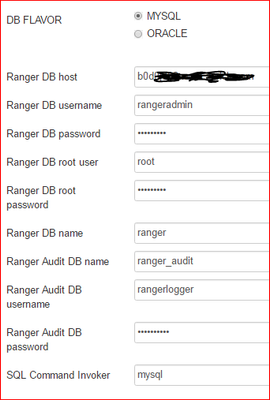

Hi @Jonas Straub , thanks for answering.
yep, audit-to-db is marked in HDFS Ranger plugin config, I checked MySQL directly as user 'rangeradmin', but the table xa_access_audit is empty.
These are the settings for Ranger MySQL in Ambari =>
