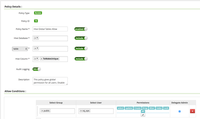

Policy 15 is a global allow policy on all Hive tables, all columns:

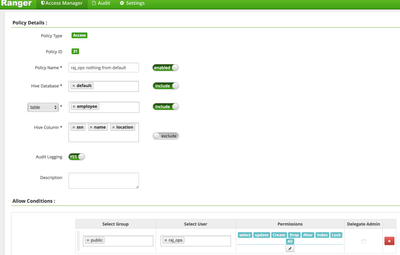

then I have policy 31 like this:
But whatever I try, user raj_ops still can run 'select * from employee' and get results.
Policy 31 is not evaluated as a 'deny' on the resource. I know you can add explicit Deny Conditons to the hive service, and I will try that. But the question is what the EXCLUDE switch (after the Hive column* box ) is good for when it is not picked up.

For the moment I will not use this exclude switch because it behaves not as I (and my client) would expect. I will go for the Deny Conditions extension for the Hive service.
The exclude switch is confusing in that it seems to swap an allow into a deny, but it doesn't. It only excludes the resources from the policy

you mentioned there is a global allow policy , can you please attach screenshot of that too
Super Collaborator
@Deepak Sharma added in main question
@Jasper in policy 15 i can see you have added * resources for all and raj_ops is part of the user , so he is able to access all

@Deepak Sharma Yes, but I would expect that if 1 policy (15) says 'yes' and the other (31) says 'no', then it should be 'no' . As is stated in the schema in the manual
No @Jasper this will be the case when there is deny condition for raj_ops , then raj_ops will be denied from performing operation, but in current scenario you can see both are allow condition , in such case if any of the condtion match then it will be allowed , and even manual also says same !
