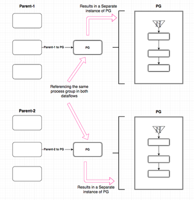

Hi All,
Is there a reusable process group in NiFi ? When I say reusable, I mean similar to how a function works, you define it once and call/use it many times, but it is defined in only 1 place; and if you change the function's code, the change is reflected in all places where the function is used; When I try to reuse the same process group in multiple dataflows, I'm actually getting separate copies/instances of the process group; if I make a change in the reusable process group, I want the change to be reflected in all dataflows where this reusable process group is used; however, what I'm finding in NiFi is, you've to make the change in each instance of the process group.
How do I get function like behavior when I want to reuse a process group ?

Hi @Raj B,
At the moment, it is not possible to achieve what you are looking for. There is a feature proposal for that here:
https://cwiki.apache.org/confluence/display/NIFI/Reference-able+Process+Groups
You may also find the following of interest:
http://apache-nifi-users-list.2361937.n4.nabble.com/Process-Group-singleton-td535.html
Hope this helps.

thanks @Pierre Villard; it's good to know it's in the works.

you can use Input port and Output port for this purpose.. Data flow 1 will send data to PG.. Data flow 2 will also send data to the same PG.. this can be done using the Input Port within the PG and if there is any Output from the PG, add Output port as well within the PG.. The number of data flows connecting to this PG = the number of Input ports this PG has..
